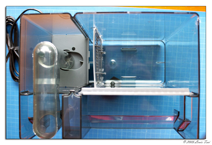

Task 1: Modifying the Aquaclear 70 HOB filter into a refugium

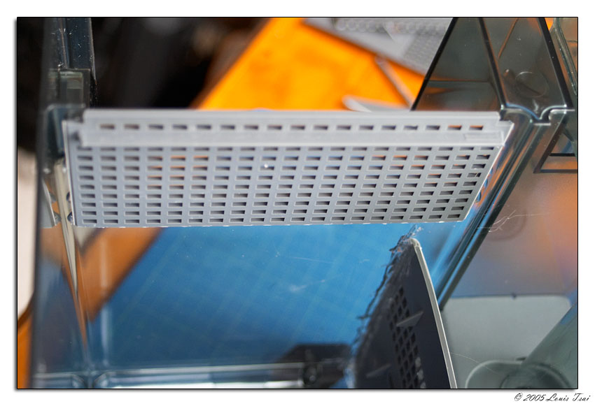

Firstly, I removed the plastic filter media tray, and cut it apart. I used a blade because I couldn't justify paying for a Dremel. The bottom piece is going to be used as a grating across the filter's return to prevent things in the fuge from going into the tank (i.e. Caulerpa).
1 of the sides is cut so and glued to create a baffle between the pump area and the fuge.

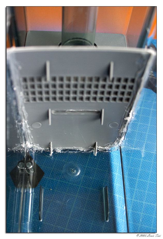

This is then glued in all the way to the bottom:
From the top it looks like this:

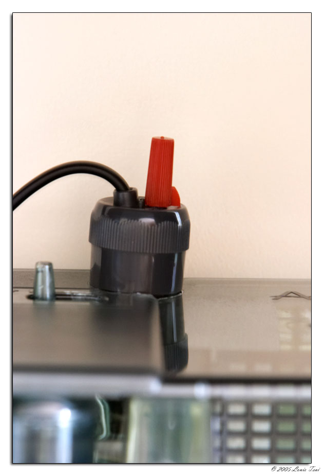

A hole was drilling into the plastic cover of the filter to allow the heater to go in. This heater is a mini sized one, it's only about 2/3 of the normal length of a 50w heater. Only 10cm needs to be submerged.
Everything in, water test!

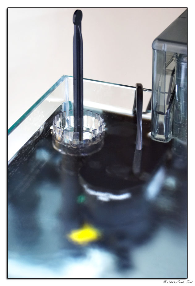

Surface skimming attachment:
