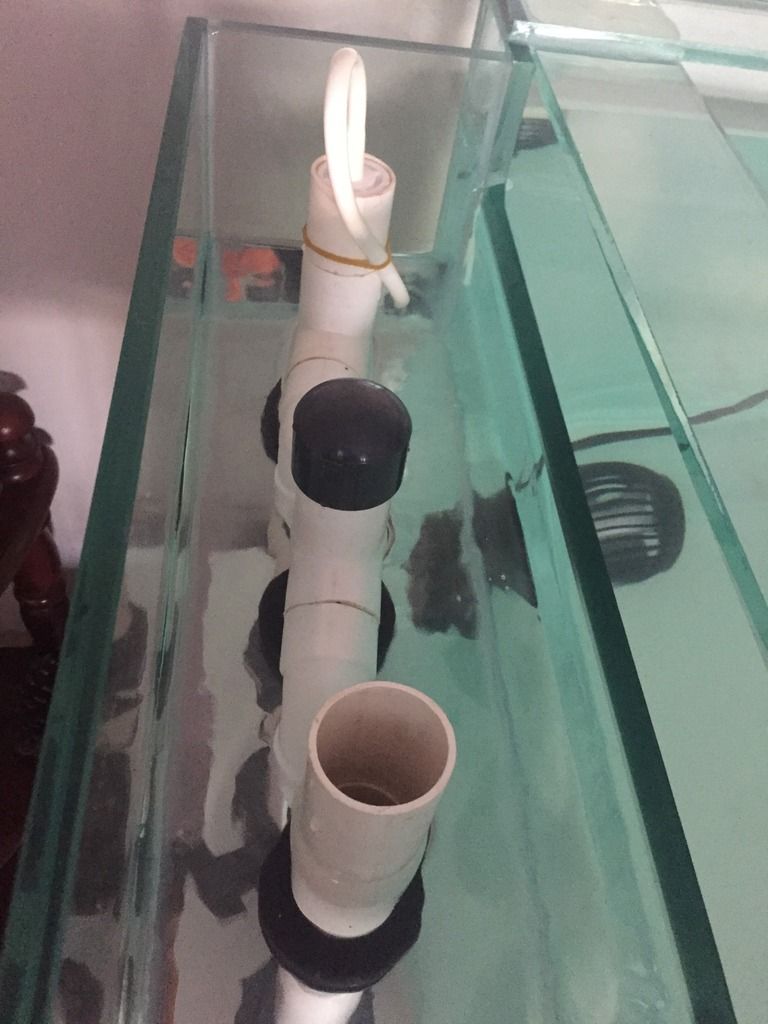

Tank is empty below
Overflow box was made with 10mm glass

the clear flexi hose you use for you return pipe has a big kink in it. since you are already using pvc pipe, might be better to run pvc all the way to the return pump and have a pvc union somewhere.
if you want to use flexi , at least use the reinforce ones, which will be more kink resistance.

There is no kink on the 6mm tubing. This tubing is the air vent on the open channel ( Beananimal).
Please see my plumbings below
Flexible is only on return pump
The return pump and Skimmer ( not set according to operating height) while on fresh water test

by SkullKill
this
look like it is reinforce flex pipes.

by patmos
yes reinforced hose...I use things available locally. When not possible I import.

by SkullKill
big kink in it. on top, which will restrict your flow
