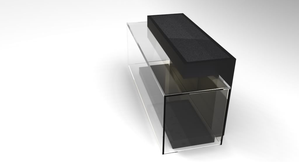

Postby callummc1 » Mon 03 Jan, 2011 6:13 pm
Here are a couple of teaser shots for the rendering that I did for Nick's tank....
Nick's tank is going to be a little over 3ft (1 Meter) - mine will be 5ft (a little over 50% larger).
The tank from the front....
Alternate front view....

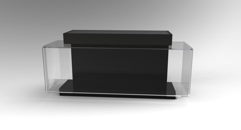

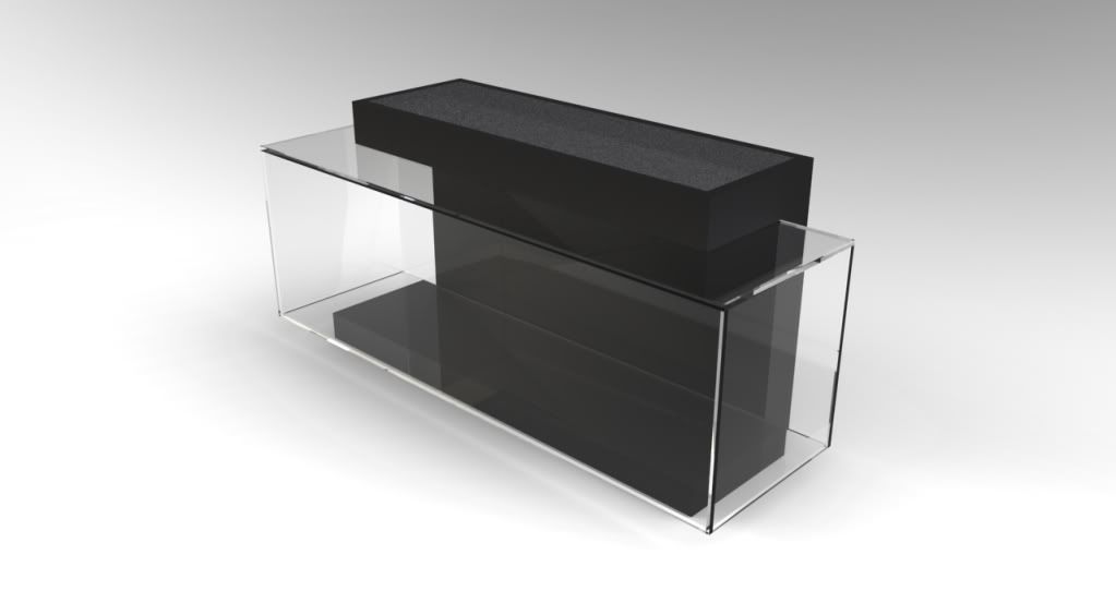

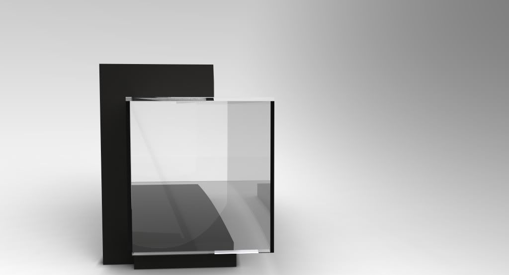

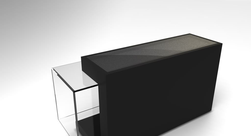

Postby callummc1 » Tue 04 Jan, 2011 10:48 pm
Ok - with a little time off from work I've had some additional time to continue working on the design....
So here is the full frontal....
This show shows the base, chimney and hood and I think will be fairly representative of the final product (assuming that I can find some way to have the base, chimney and hood manufactured from plastic.
The next shot shows the tank from the front / side....
As you can see, you will be able to look down into this from above to *great* effect.
The next shot is really just art for art's sake :)
And a side shot....
Finally - a quick flash of the rear end !
Some updates on the design front. It seems likely that I'm going to use a closed loop system on this tank, with the inlets and the returns mounted in the chimney and base (allowing for artful rock cover) to keep the aesthetic appeal.

Postby WarbyD » Wed 05 Jan, 2011 9:31 am
i love everything about it ... except the stand height haha... I personally would hate to have a tank as low as that.. looks like it's going to be a beautiful finished product though :)
As far as the base/chimney/hood goes I'm not sure I would be leaning towards plastic given the amount of weight that's going to be on that base, particularly given the unsupported area around it. Any flexing or warping of that plastic could spell disaster... Any reason you don't want to build it out of ply, mdf or even steel & skin it?
-Dave

Postby callummc1 » Wed 05 Jan, 2011 11:08 am
WarbyD wrote:i love everything about it ... except the stand height haha... I personally would hate to have a tank as low as that. looks like it's going to be a beautiful finished product though :)
Believe it or not, the height of the stand is actually carefully calculated. Our living room has some very low couches and at this height the tank will be exactly at eye level when you are sitting down.
Having it at this height also means that you can enjoy looking down from the top of the tank. It provides a rather unique view as with most tanks surface movement would prevent you from getting a clear view downwards. The glass cealing on this means that you get to enjoy a crystal clear view from the top :)
The renders above are actually Nick's tank, mine is going to be a 5 footer :). So I'll have a lot more length.... I just wish I had somewhere to fit a 10ftx4ftx2.5ft monster :thumbsup:
WarbyD wrote:As far as the base/chimney/hood goes I'm not sure I would be leaning towards plastic given the amount of weight that's going to be on that base, particularly given the unsupported area around it. Any flexing or warping of that plastic could spell disaster... Any reason you don't want to build it out of ply, mdf or even steel & skin it?
It's going to be around 300kg by my calculations. Well designed and reinforced plastic using the appropriate materials should be more than sufficient for supporting the weight. We had actually considered using a slab of acrylic for the base, the problem with acrylic is painting it :wall:
Overall plastic is being considered because there is an aesthetic look that we are trying to achieve in terms of "clean lines". We don't want any visible joins on the corners etc (like you might get with laminex etc) and we are struggling to think of any other way to do it. I'd be seriously chuffed if someone could make some recommendations in this area.
I'll try to get a couple of shots of the existing Fluval hood posted today to show the effect we are looking for.

Re: Floating Tank Design - Now with full tank shots / render
Postby WarbyD » Fri 07 Jan, 2011 12:40 pm
Postby callummc1 » Fri 07 Jan, 2011 12:49 pm
Postby callummc1 » Fri 07 Jan, 2011 12:57 pm
mattgreen wrote: have another look at the renders.
(its completly sealed except for a small opening thats taller in the middle)
It's probably better to look at the sketchups on the first page as they show the overflow / weir as well.
Matt's right though... The water comes all the way up to the ceiling and spills out into the overflow.
