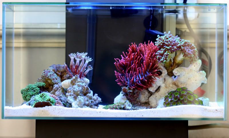

I was inspired by the many nano reefers who experimented with this tank and managed to sustain a sucessful ecosystem, like the one below;
[Minh Tran's Fluval Edge Marine Tank]

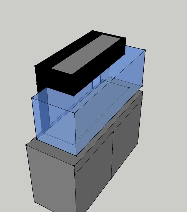

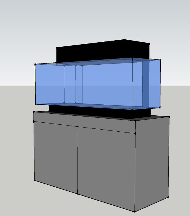

So the following tank design is inspired by the "Floating Tank" design of the Fluval Edge;
The dimensions of the tank will be :
38L x 12H x 12D inches
The stand will be :
40L x 20H x 18D inches
Here are a couple more shots of the design.
From the top, providing a sense of the "floating" aspect;
From the side, showing off the amazing "water cube" perspective;

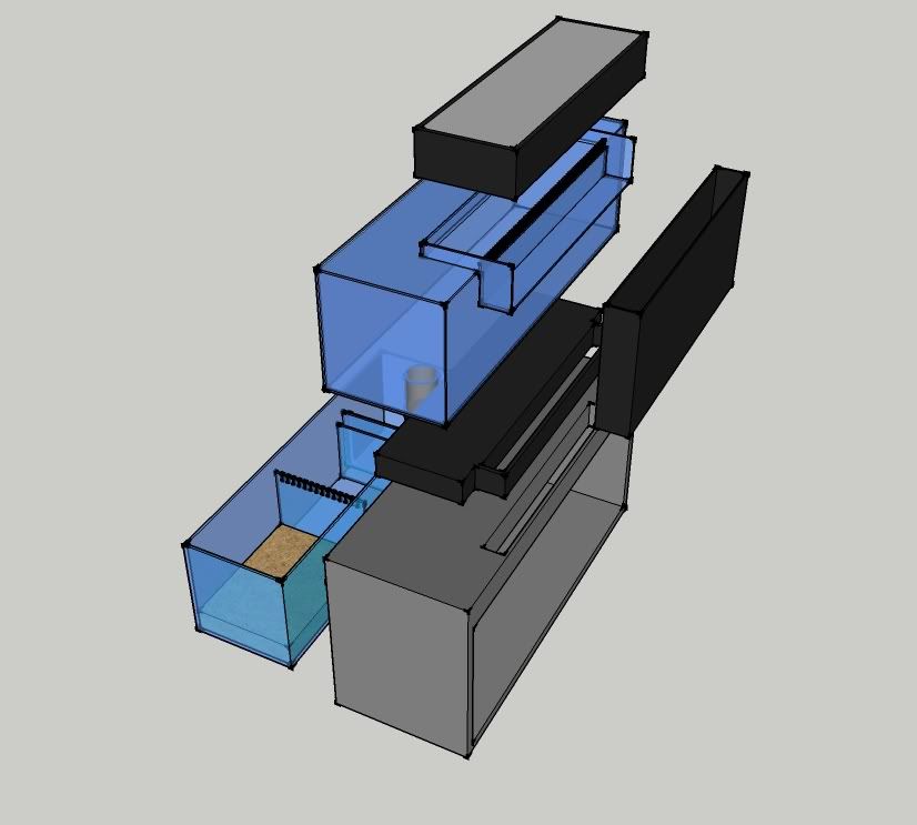

The following shot provides an "exploded view" of the rear of the tank, where you can see the weir and the hood / chimney that will surround the weir and plumbing;
As you can see, the stand will have holes cut to allow the plumbing to feed directly into the sump.

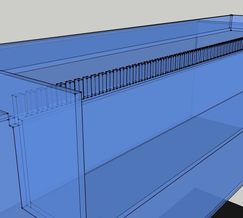

A close up of the weir / overflow (please note that the rear wall of the weir is not on yet - I'm about add the plumbing to the diagram) from the rear of the tank;
At this point, I expect that we are going to use a slightly modified version of Bean Animal's overflow system;
The difference being that our pipes will actually come up from underneath and into the overflow box, which sits on the back of the tank.

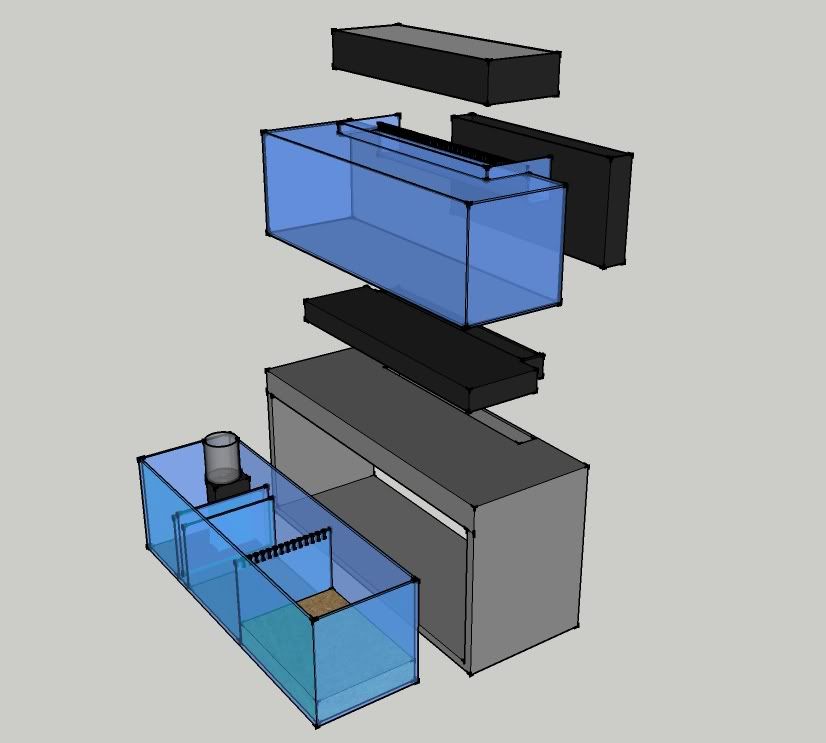

The sump is going to be nearly as large as the display tank (100 litres) and is likely to have three chambers;
1. An intake chamber / skimmer chamber (Tunze 9002)
2. A return chamber
3. A refugium chamber with DSB, Live Rock and Algae
We are struggling at the moment to keep the asthetics of the tank / stand in the dimensions that we would like. We are currently investigating the potential to have the sump placed on a tray that can be pulled out of the stand for easy access;
If this works, then the sump could be pulled out to a position similar to the one shown in this photo;
